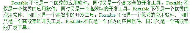

示例
Dim
wdc
As
New
WordCreator()
Dim
fl
As
String
"c:\temp\test.docx"
Dim
txt
As
String
For
i
As
Integer
= 1
To
5
txt = txt &
"Foxtable不仅是一个优秀的应用软件,同时又是一个高效率的开发工具。"
With
wdc.AddParagraph(txt,New
Font("宋体",
9))
.ForeColor = Color.Green
.FirstLineIndent = 20
'首行缩进20
.SpaceBetweenLines = 10
'行距为10
.Alignment = Word.RtfHorizontalAlignment.Justify
'文本两端对齐
End
With
wdc.Save(fl)
Process.Start(fl)
生成的Word文件内容:
