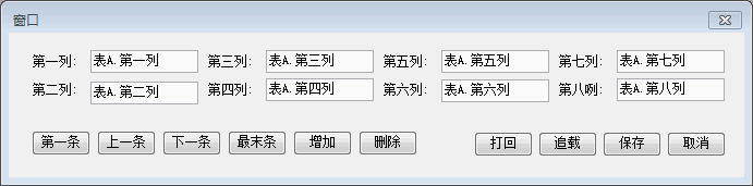

8、新建一个下图所示的窗口:
为了编码方便,八个文本框的名称和其绑定的列名保持一致,例如第一个文本框绑定到第一列,其名称也应该设置为第一列:
将窗口的AfterLoad事件代码设置为:
e.Form.Controls("第一列").Enabled = (User.Name = "张三")
e.Form.Controls(
"第二列").Enabled = (User.Name = "张三")
e.Form.Controls(
"第三列").Enabled = (User.Name = "李四")
e.Form.Controls(
"第四列").Enabled = (User.Name = "李四")
e.Form.Controls(
"第五列").Enabled = (User.Name = "王五")
e.Form.Controls(
"第六列").Enabled = (User.Name = "王五"
e.Form.Controls("第七列").Enabled = (User.Name = "赵六")
e.Form.Controls(
"第八列").Enabled = (User.Name = "赵六"
上述代码确保每个用户只能编辑自己负责的列。
