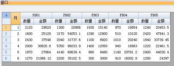

有效的,执行上述代码前要先Focus,如:
Dim g As New CrossTableBuilder("窗口2_Table1", DataTables("订单"))
g.HGroups.AddDef("日期", "月")
g.VGroups.AddDef("产品")
g.Totals.AddDef("数量", "数量")
g.Totals.AddDef("金额", "金额")
Tables("窗口2_Table1").DataSource = g.BuildDataSource()
Tables("窗口2_Table1").Focus
Tables("窗口2_Table1").Select(0,0,0,Tables("窗口2_Table1").Cols.Count-1)
Sendkeys.Send("{Tab 3}~")
Syscmd.Column.Width()
Tables("窗口2_Table1").Select(0,0)
效果图:
